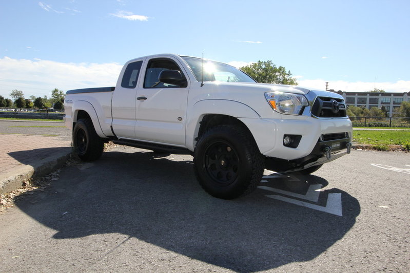

      That looks sick! What size wheels and tires ? Any lift ? Any rubbing ?
    • bubagump74
      Stock OR suspension with Pro Comp 7096 wheel (17) tires are BF Goodrich all terrain T/A.275-65-17
      I had to trim a little bit of plastic for clearance at full right/left stop and removed the fwd and aft mud flap in the front ,back is ok.
      I would not go any bigger on this set up.:gossip:
      Cheers !:mudding:
    • Wakecoach
      Thanks man. Looks awesome
