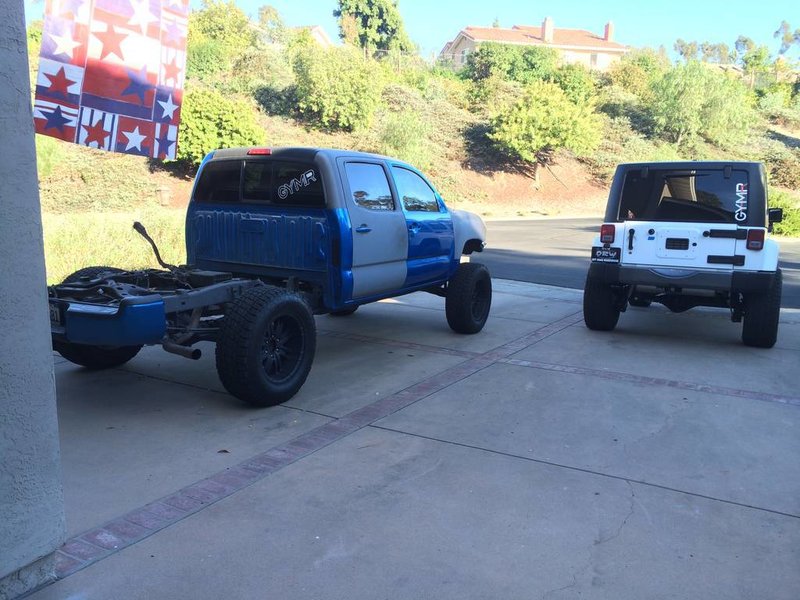

      So did you do your door one at a time with the vinyl or did you lay down one big vinyl I'm having issues cause in between the door you can see the actually color of my truck
    • rmahoney2013
      @Leaningtacoma Sorry for the late response.. I did each door one at a time and wrapped the excess over and around the door. The tacoma doors have a little gap in between so I was having the same issue. I ended up wrapping part of the door jams, especially the pillar between the doors and behind the back door. Its a big waste of vinyl but I did the top of the cab and the jams as one piece
