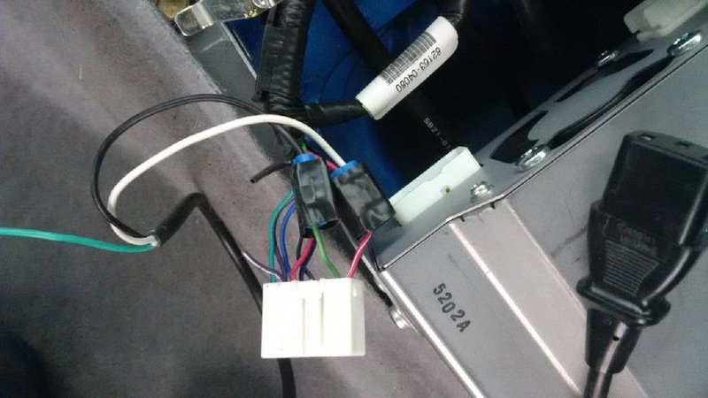

in cab AC Outlet
wiring at AC inverter plug. Note Violet/w white stripe wire cut, and heatshrink applied. AC connection is to a surplus computer cord. Cord connects to wiring at AC outlets at rear of console, such that the console can be removed.
