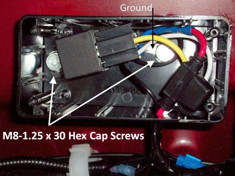

Inside a 30amp Fog Light Relay, and 15amp in-line fuese. The whole Fog Light system is grounded to one of the M8-1.25x30 Hex Cap Screws holding the box to the engine compartment wall.
