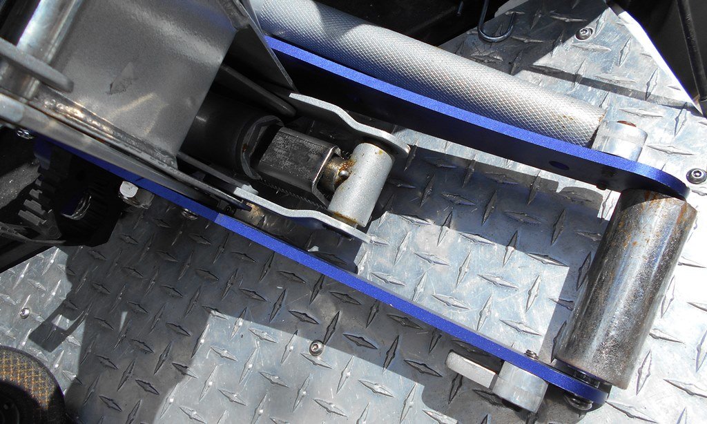

Collar fitted over the jack ram. Length determines the set point where the lift pad stops. Will have to experiment with lengths and fit the collar with a handle to keep fingers out of the jack frame.
