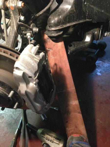

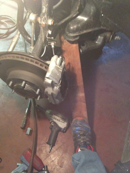

When installing front coil overs I only removed the two bolts connecting the LCA to the ball joint knuckle and then used a 2x4 in this location to step on and force the LCA down. I did not loosen the cam bolts for the LCA. Less work this way.
