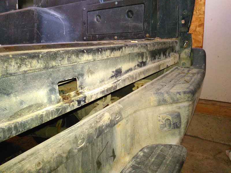

Normally the top surface of the bumper and the bottom of the box are flush. After you remove the 6 retaining bolts, the box has to come straight up if the bumper is still on.
