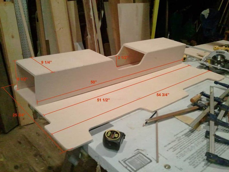

Overall: 54.75" x 25.75" x 7". This allows the seats to be comfortably far back (I'm 5'10" YMMV). Drawers are 19.5" long x 8" wide X 4.5" deep. Notch in front is 2.25" deep. This allows unit to slide forward (with seats moved forward), to clear the seat belt anchors. It can be then tipped forward to access the storage compartment/jack or be removed. These dimensions assume that the storage compartment lids, seat belt center buckles, and seat bottoms are removed. Seat belt holes are plugged to prevent water incursion.
