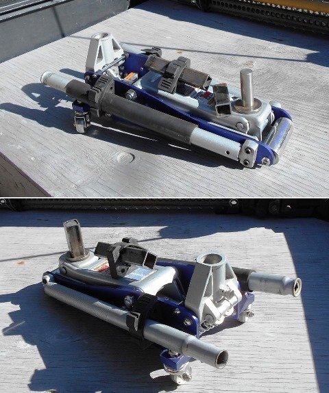

Modified 1-1/2 ton HF jack
I wanted a small garage jack to facilitate tire changes when the truck was being used as a DD. After looking at some of the many modded versions seen on line - and not too thrilled with them. Decided to build my own.Added rubber grips and brackets to hold the handle. Fitted a 3" tall 1" spindle.

      Its a work in progress, intended for use on pavement. Still working on a configuration for the extensions / cap pads. The square tubing is 1-1/4 x 1/8 wall and fits snug on the 3 inch high x 1.0 dia nose spindle.
