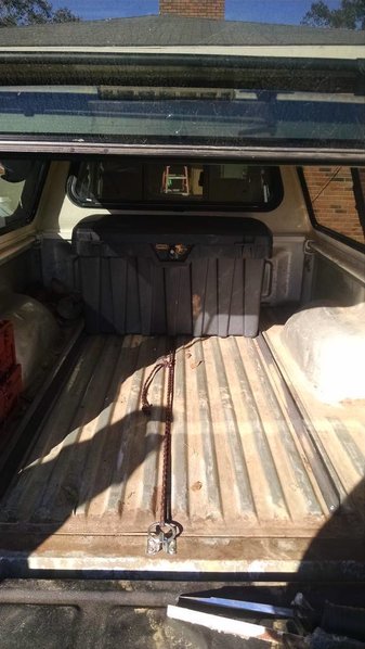

My toolbox slide/guide/pully system
Super simple. x2 pieces of 6' angle iron for guides X1 pully in the back X1 ring in the front ~10 self tapping screws ~12' length of rope -- Run the rope through the mounted pully & ring and attatch each rope end to their respective side of the toolbox. -- The system works great! doesnt hop, or slide, and keeps you from having to crawl into your shell to get your tools!! It also keeps the weight of your toolbox in front of the axle.
