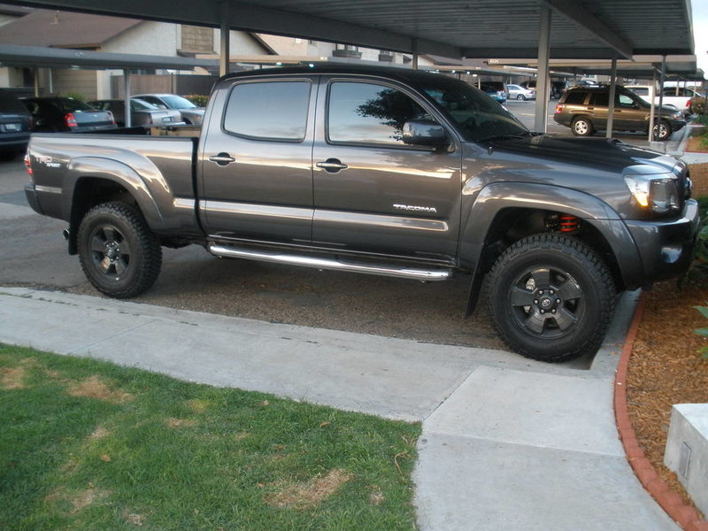

I like your truck. Did you dip your wheels or have them painted ? I cant afford new rims but i plan on buying some new tires and was going to think about painting the rims black.
Wheels were scuffed with 100 grit sand paper, primed with self etching paint and the rattle canned with enamel. The paint seems to hold up pretty well. I'm not a fan of aftermarket wheels.
@TomHGZ they were first coated in black and then painted in graphite. They're still the same 8 years later and look great. I would do it again.
