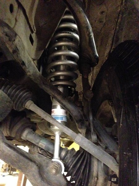

new coilover
new coilover

      Are those just your stock UCA's? Did you upgrade them after this picture? or was you aliment okay with 5100's and the toytec shocks? Also which shocks did you get and also which level was it on? sorry for all the questions!!
    • dakotasyota
      @tacoma-yyc I switched out to LR UcAs shortly after this. I couldn't get back into allignment without them.
      This is toytec 620 lb coils with 5100s set at the lowest "lift" setting (.85) I also had 1/2" top plate spacers.
