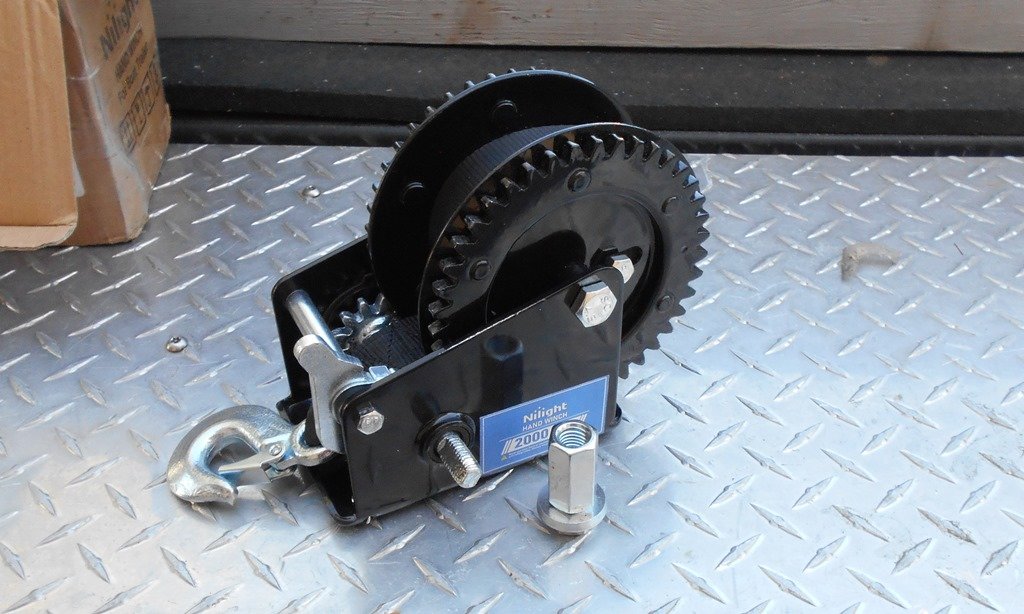

Wanted a strap style come-along that had some reach - like over 20 ft. Boat winch came to mind. Don't get one with single side gear or double reduction input - junk. Crank that comes with it isn't useful - fitted a coupling nut with Loctite.
