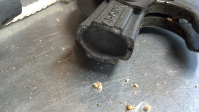

Note the air bubble void spanning the already meager casting wall. This is the same failure mechanism on 1st gen plastic quarter window latch links.
