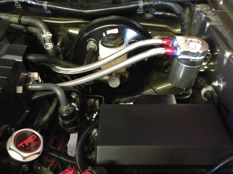

Oil Catch Can

      Oil catch can???
      If you don't mind me asking,,,,,
      What is it?
    • Mully
      It is connected into the PCV system. The oil catch can collects the oil mist and condenses the fuel vapors while allowing “cleaner” gases to be passed back into the intake. Typically the blow-by gasses are passed through a wire mesh, which give the vapor droplets something to adhere to. I empty it every time I fill up with fuel, there is about an ounce of oil, never put it back in your motor.
