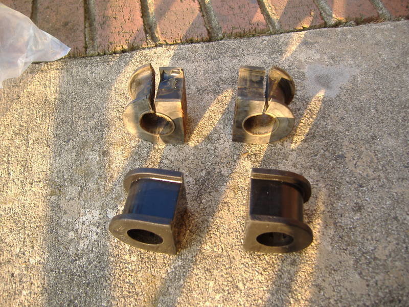

old versus new........polyurethane sway bar bushings
these are the old rubber stock sway bar bushings that i took off, and under them are the new energy suspension sway bar bushings i installed. it wasnt too hard to install.....but i recommend taking one side off/loosening one side to make the removal and install a little easier. the stock rubbers were worn slap out....and these new poly's you can actually tell a difference with. i highly recommend them.

      yeah........i had to have this stuff so i can drive the truck without something really messing up since the stock everything is so worn out!! and my wife agrees with you!!
