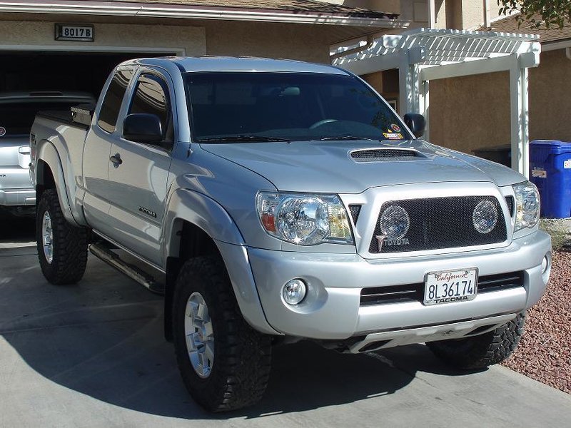

      I love the way this sits. what lift/level is on this? I have a 2005 prerunner same color and want mine to sit like this. Is it just 2" in the front and 1" in the rear?
      Thanks!
    • JJ Customs
      This was OME sport shocks in the front with 885 coils and a single OME add a leaf in the rear. 265/75/16 Goodyear Duratracs for rubber.
