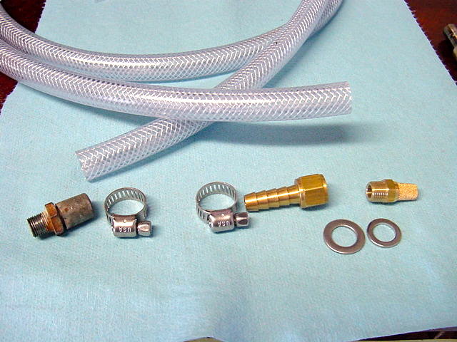

OEM breather removed for disassembly. Note original length of brass nipple...you'll need (2), photo is misleading. Air compressor filter becomes breather tip. Use stainless and brass to resist corrosion. Reinforced plastic hose is strong & flexible. Most importantly: KISS...keep it simple stupid!
