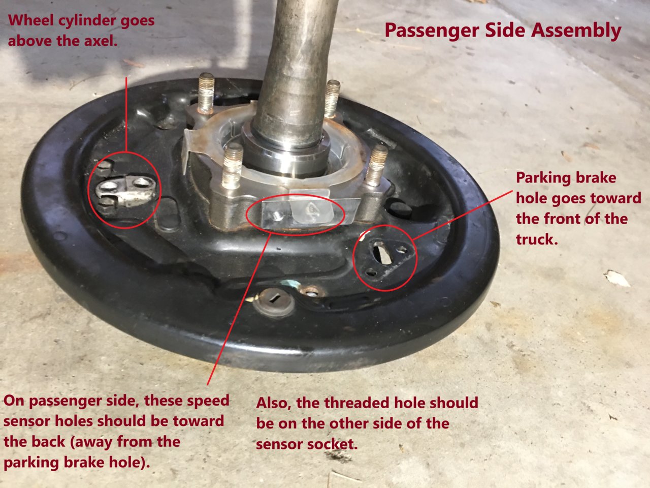

Passenger Side Axel - Annotated
Passenger side hub / bearing was installed incorrectly. However, if it is simply rotated 180 then the speed sensor won't fit into the hole because the bolt is at the top.
