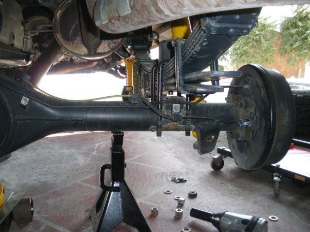

Pinion Angle Axle Shim
Lowering 1 side at time. You can see the leaf pin bolt and just enough room to slide an axle shim. Don't guess on a shim angle, every lifted truck's angles can differ by just half a degree which is enough to move u-joint operating angles in and out of tolerance and enough to give you vibes or no vibes.
