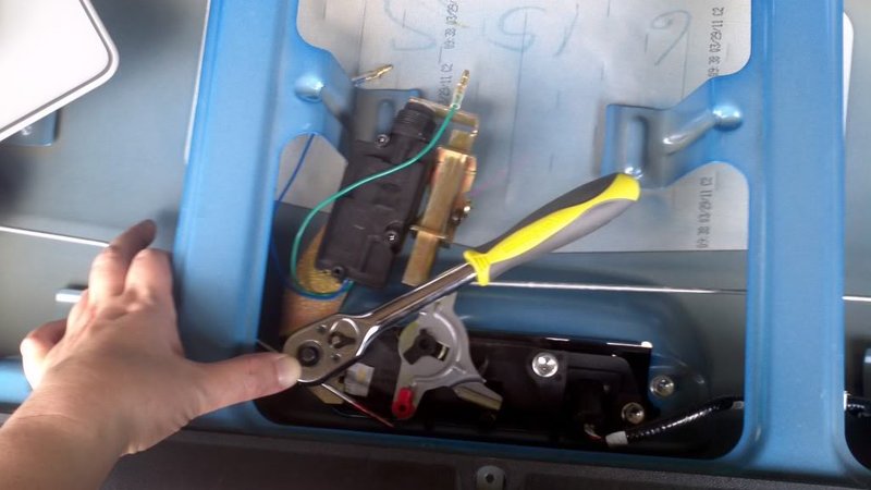

Very simple install. First I unhooked the driver's side lock rod from the red clip you can see in the picture. Then I removed the 10mm bolt on that side as well so I could put the actuator bracket in place there against the OEM locking mechanism and then tighten the same bolt back over both to hold the actuator in place. Notice in this shot that the actuator bolt is actually in the closed/locked position which meant I couldn't pull the tailgate handle to open it.
