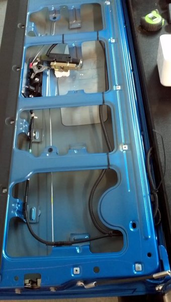

The guy did a really good job overall. When he opened up the tailgate panel to connect it to the final long run wiring he was very conscientious about rerunning and zip-tying the wires all the way to the drain hole. I cut a small piece of rigid white styrofoam from the head unit's packing material and it was the perfect height for putting beneath the actuator to keep it from vibrating and cutting noise during operation -- it was a tight fit but I also used his hot glue gun to keep it from shifting in future.
