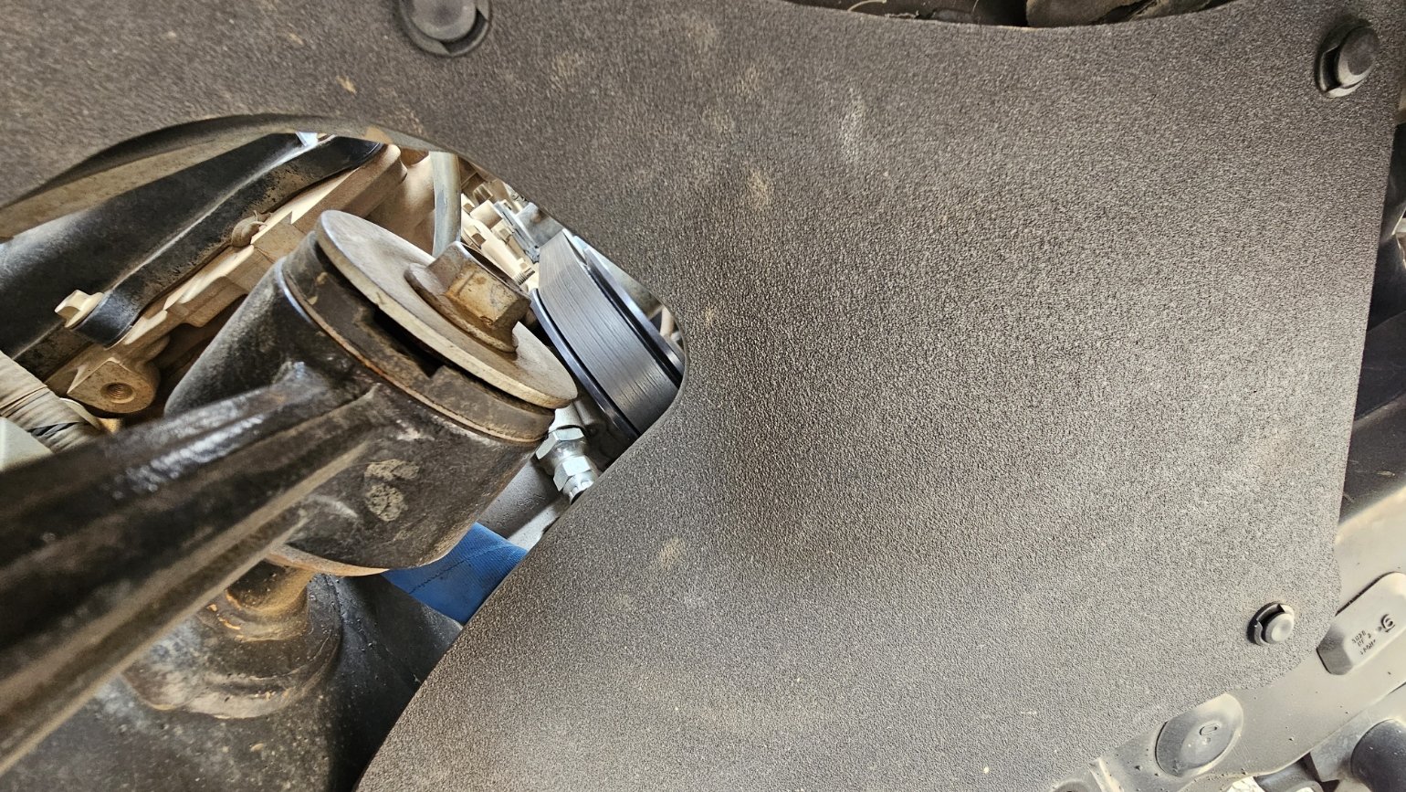

Before the blue hose there came out in front of my OEM splash guard and then did a big loop to the reservoir filter. You can shorten this hose down enough to make the loop fit just behind this new Ark splash guard and it no longer touches the frame anywhere.
