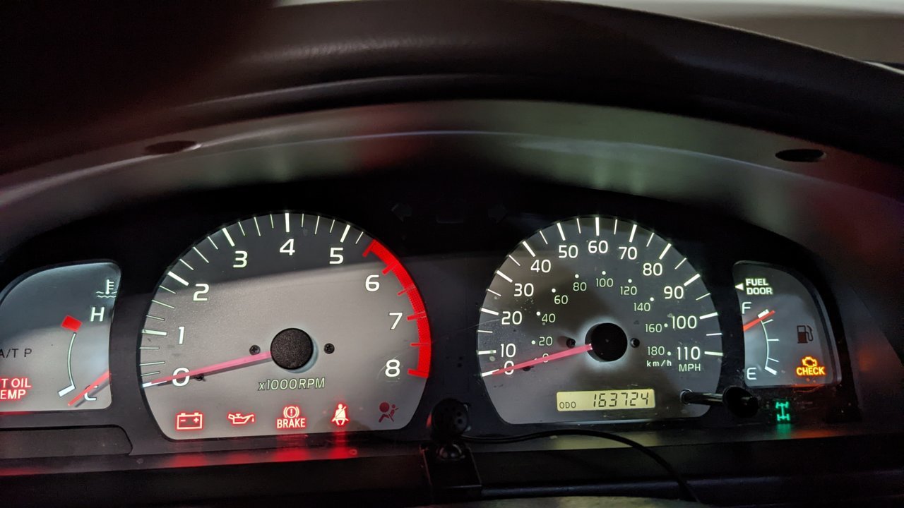

4WD Swap - Testing 4WD Indicator. Also not lit but functional is the A/T P indicator/warning light. If the transfer case is in Neutral, alerts the driver that the driveshaft can still spin even if the transmission is in Park. Swapped in a temp gauge with the A/T P and A/T Oil Temp cutouts.
