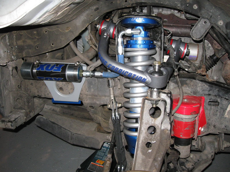

Re-upgraded front syspension
Replaced some broken and worn out components.
mjp2, Sep 29, 2008
    • mjp2
      They're now spares in case of breakage during the race. :)
    • silver07taco
      And the UCA herd you snapped one of them good work, Looks good, I want to upgrade the toytec coilovers soon
    • RelentlessFab
      damn.... theres some money tied up right there. lol. sweet setup
    • mjp2
      True, but the interior is what REALLY put a hurtin' on my wallet! :p
    • Khaos
      How much travel you getting?
    • mjp2
      Not much extra travel beyond stock. I have to use the stock lower control arms for class 7sx so no long-travel for me.
      An option would have been to move the upper coil bucket to fit a longer shock but it would put more of a strain on the CV joints. The suspension is going to be revamped yet again during the first few months of next year but what you see is a good start.
