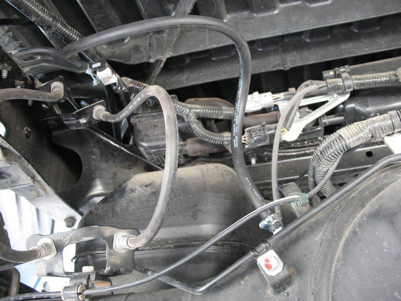

Here is the breather hose coming off the bracket and running straight to the axle. I used more slack than the brake lines. I also put a coil into the hose so it stays centered in space above the axle.
