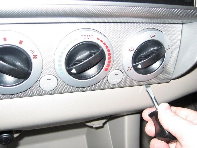

This photo shows that, with a large flat bladed screwdriver or putty knife, you can remove the climate controls without marring the dash or breaking the pins. It is fairly easy to do.

      There's a better way to do this...take off the plate under the AC vent and reach through there to push that panel out.
