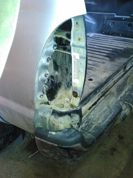

There are 2 10mm bolts on the inside of the tailgate pillar. Disconnect the wiring harness here, and feed it back through the hole in the bottom of the box.

  • Be care ful turning the nuts out. I broke the threaded portion on the light housing cause the nut was seized. Not sure how you can avoid that
