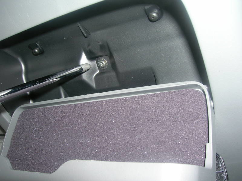

Removing the overhead console
The screw inside of the sunglass holder is the only one that needs to be unscrewed to remove the overhead console.
