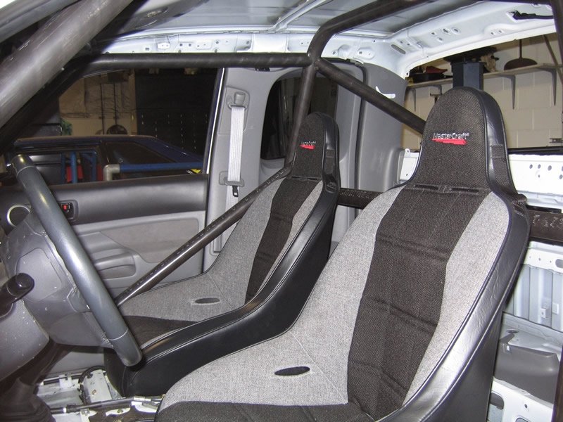

It's getting closer! The door bar on the passenger side is just there to check clearance. I'll be able to keep the inner door panels with some trimming of the rear section of the armrests. There'll be some additional head protection when all is finished. The thin sheet metal on the roof won't do much in the event of a rollover, and the height of the bars coming off the main hoop won't quite cut it for a tall co-driver.
