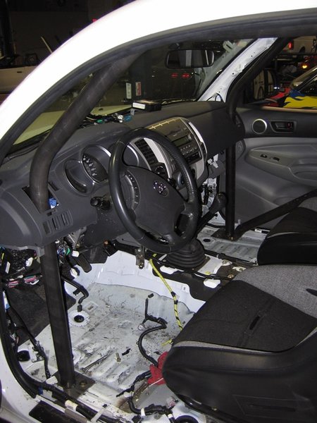

Rollcage through the dash vent openings.
I'm pretty psyched at how the project is coming along and wanted to share. :) The 2" chromoly tubes fit perfectly through the side vents without any trimming of the dash. The glove compartment will be trimmed to accommodate the tube running to the floor, but it'll still be there and will remain functional! The angle bar against the passenger door is just there for fitment in this picture. It looks like I'll be able to keep the inside door panels with minimal trimming of the rear of the armrest for that bar to fit with the door closed.
