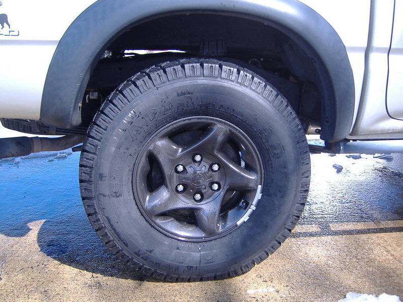

rustoleum hammered finish paint(yep....gotta paint the weights too)

      How did you get those painted? how can you paint the alloy wheels ? what paint and what materials do you need?

      i washed the wheels real good with dish soap and a scotchbrite pad. dried them real good........sprayed them with some duplicolor etching primer(about 3 coats), then i sprayed them with rustoleum hammered finish black and did about 3 coats of it. let it cure over night.
