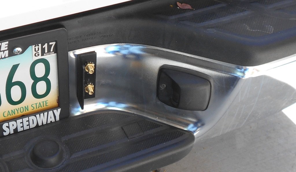

Separate Schrader Fill Valves
Using two independent valves allows a differing pressure from side to side. Angle guard keeps my boot toes off the stems.
