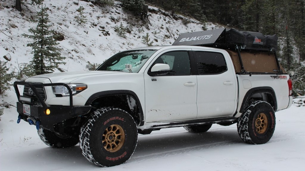

      What size of tires are those? Im planning to get 37's on mine with a 6 inch lift kit, im running 33's with a 3 inch lift .. no rubbing issues so far but im digging the generals and i want to go big hehe. What can you tell me
    • 90yota
      @Geral13 thanks! You have a nice looking build yourself. One solid piece of advice is bigger is not always better. I would leave it as. For 37s you will NEED to regear. Gears are about $1500 and you should save at the very least another $1000 for install. Not to mention the work involved in the bds kit. I think 3in lift is plenty and my 35s are maxing that out. I'm not a fan of drop bracket style lifts but the each their own. Strongly consider what is involved with a drop bracket style lift. Even with 37s you'll probably see some rubbing. Depending on the wheels you choose that could help or male it worse. But if you have the money to blow go ahead and do it! If it's the style you are going for and you like it, that is all thaty matters.
    • Geral13
      Thanks a lot! I already bought the 6 inch kit and i dont want to change the rims though... but those generals looks awesome for real , nice build!
      90yota likes this.
    • 90yota
      @Geral13 thanks! I appreciate it. They don't make them anymore. They discontinued them. As far as tires go, if you do go with 37s just be aware of gears, brakes and all the trimming that is possibly needed
    • Geral13
      Yeah , i thinking to get the 4.88 gears , i didnt know that thay discountinued them.. thats a shame... :( , well i have to get in love with another tires then hehe
