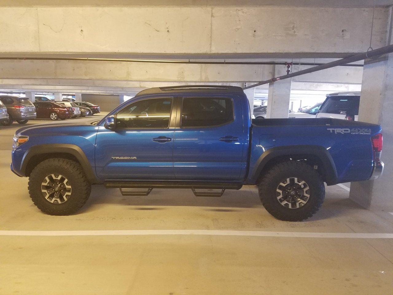

255/85R16 Toyo Open Country MT
Skinny Club
Wesintex, Aug 3, 2018
    • remotemedic
      So I have read others on here that say they put the same set up on stock TRD off-road and had bad issues with rubbing! This is the size tire I would love to order for some Ray 10’s that are on the way but I keep getting conflicting stories about the fit. I do plan on a small lift.
    • Wesintex
      @remotemedic I think the biggest determinate of this tire size rubbing vs non-rubbing on a stock TRD OR with this tire size is the wheel. With a Stock OR wheel, I have had 0 rubbing issues even offroad with a good amount of flex in the truck. The reason these work as 33" is because they are narrow combined with the backspacing of the OR Wheel. I am not sure how the Ray 10's compare to the stock OR wheel.
    • Phoenix2000
      The mud flaps are probably the difference between rubbing and not rubbing.
      Daystar makes a good spacer kit. They can tell you how large a tire you can fit with their lift.
