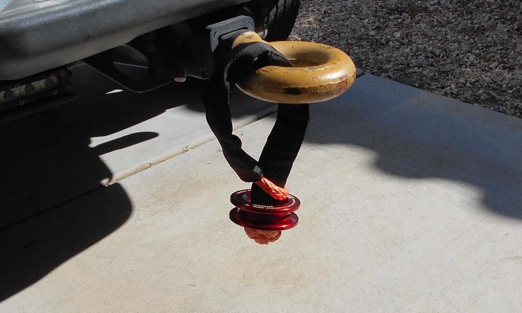

Soft Shackles have been known to "slip the knot" - if poorly made or mis-installed. Using a winch ring as a soft edged washer can eliminate a potential problem. Takes two if the softies are on both ends.
