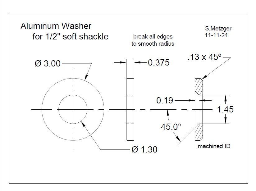

Soft Shackle Washer Drawing
Thick aluminum washer made to insure a soft shackle can't slip the knot. Works best to size the finished hole to "just fit" the shackle.We were thinking of "dishing" the washer in our press using an old hitch ball and forged socket - haven't tried it yet. Material was 6061 T-6.
