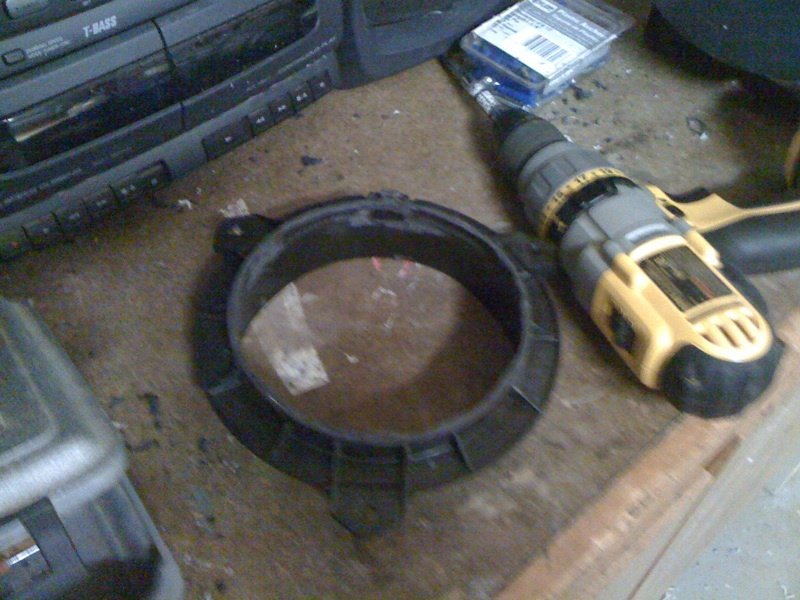

Stock speaker, using the built-in spacer as a spacer for my aftermarket speakers. Pic 2/4 Used a knife to cut out the cone, then used a Dremel tool to smooth out the plastic support arms holding the magnet. Then use a screwdriver to pry out the white connection for the stock wiring harness.
