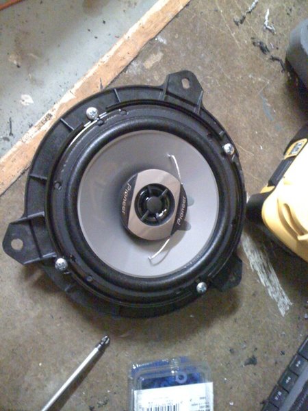

Stock speaker, using the built-in spacer as a spacer for my aftermarket speakers. Pic 3/4 Placed speaker inside of empty spacer, and used the aftermarket speaker as a guide on where to drill screws. Remember when connecting the speaker wires to the speaker to slide them in through the hole where the stock wiring harness was, so as to not pinch them off.
