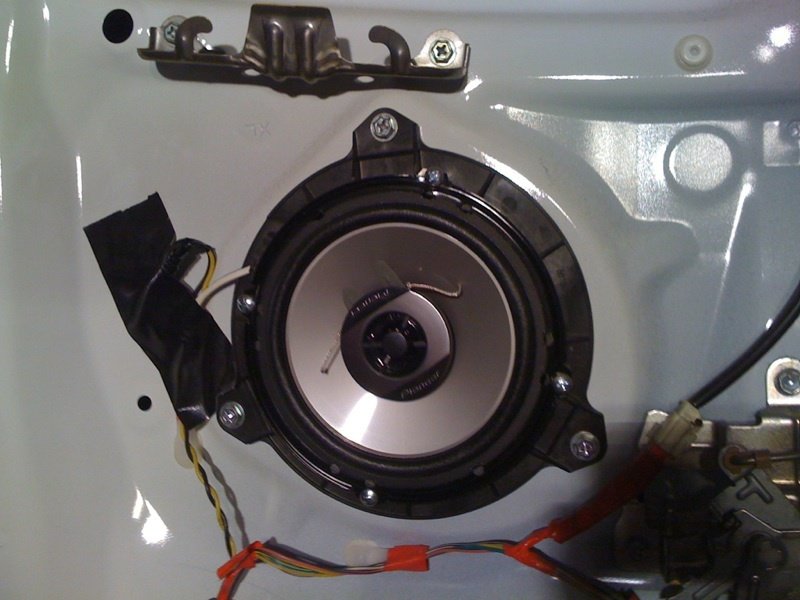

Stock speaker, using the built-in spacer as a spacer for my aftermarket speakers. Pic 4/4 The installation took a little effort. Since the screws holding the aftermarket speaker in place catch on the door, I attached a grinding stone to the drill, and ground away approx. 1/4" where the four screws were catching on the door. Then replace the 3 screws that hold the spacer in place. Perfect fit.
