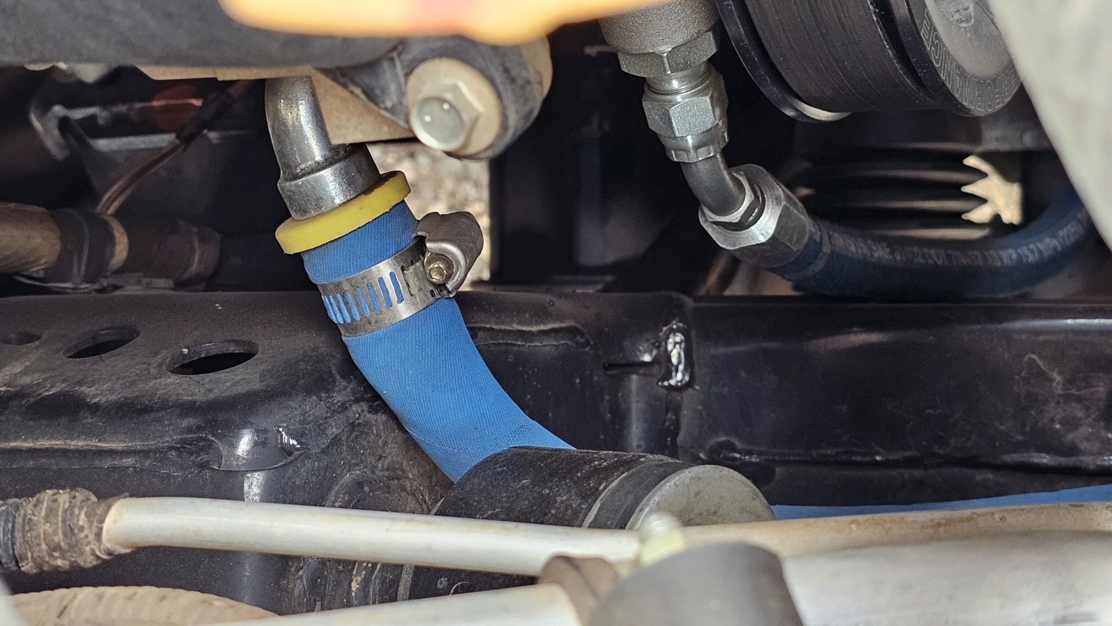

Steering Pump - Side&bottom View
You can see the hose just barely touches the frame. Had massive issues with bumps would push on the hose and actually loosen up the fitting and cause minor air intake leak here.
