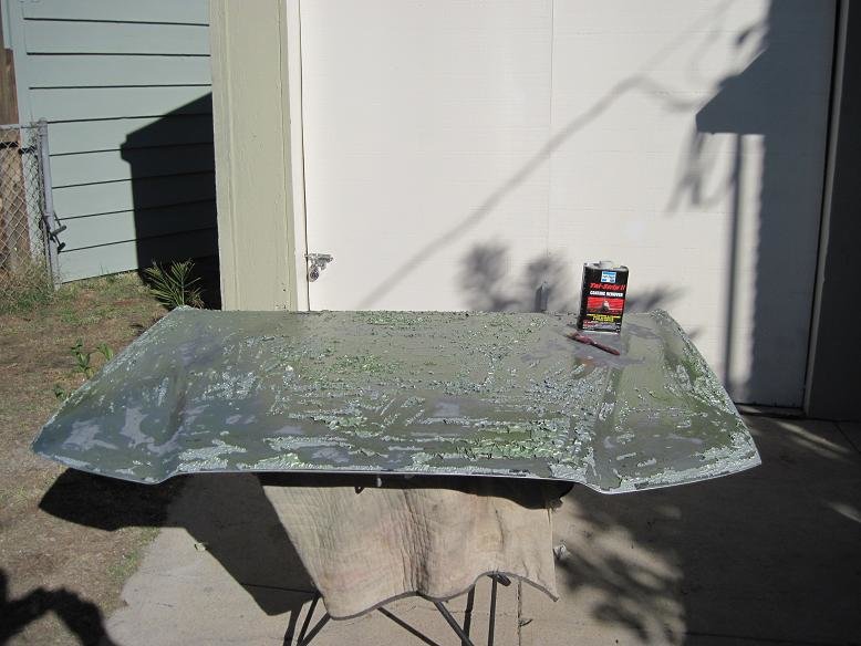

Strip hood to steel
Hood had some deep scratches to metal. Doing body work on a hood is not a good idea. The hood has the highest paint stress of any panel. The thinner the paint the longer it lasts. So I removed all of the factory paint.
