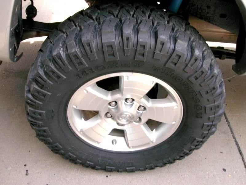

33X12.50X17 Mickey Thompson MTZ's on stock wheels. (Had to use 1" spacers to fit)

      How much road noise do these tires produce?
      They look sweet!
    • tacoGrande
      Thanks,
      They're not too noisy for mud tires. There's a low hum when I drive. They are great tires. These are my second set. The last ones were on a 03' Silverado and I was surprised at how well they got around during daily driving.
    • Justin626
      Before you added the spacer, what components were the tires rubbing on? Also, did you have any problems fitting the wider tire on the stock rims?
    • 08_TACO_offroad
      i think he had to use the spacers on the front to clear the calipers, i had to use the same thing, only on my front wheels though
    • tacoGrande
      It was the upper control arm. I was 1/2 to 3/4" to wide with the tires. I had the tire place put some 1 1/4" spacers on which turned out to be junk because they were not hubcentric. This caused the wheels to wobble really bad. I just bought a set of spidertrax 1 1/4" hubcentric spacers and put them on and no more wobble.
