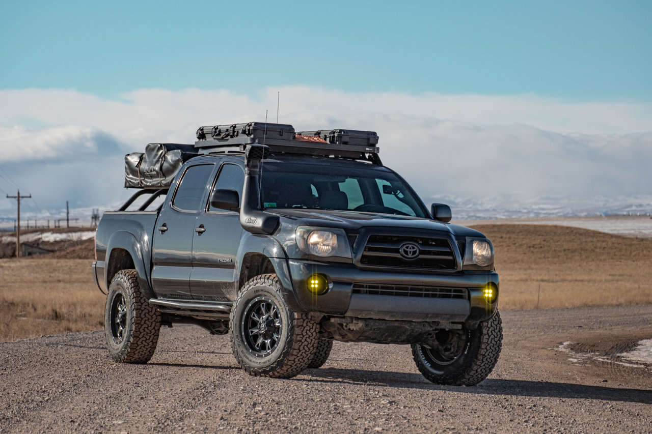

      Hey question for you regarding your set-up. Are those Pelican boxes on the roof rack?
    • OvrlandTaco
      @FishyTaco1976 yes they are, 2 pelican 1750 cases bolted to the rack
    • FishyTaco1976
      I thought so. I purchased a Pelican Vault 700 case (not as sturdy but much lighter weight than the standard Pelican) and want to do the same thing. What kind of mounting hardware did you use? I have an ARB flat rack, made up of approx. 1.25" diameter tubing. Thanks for the reply!
    • OvrlandTaco
      @FishyTaco1976 I used a hex bolt to slide into the t-channel on my roof rack slats and drilled 4 holes into the pelican cases. Put the pelican cases onto the bolts and use lock washer an nut on the inside of the case and finish off with a little bit of silicone to keep moisture out.
