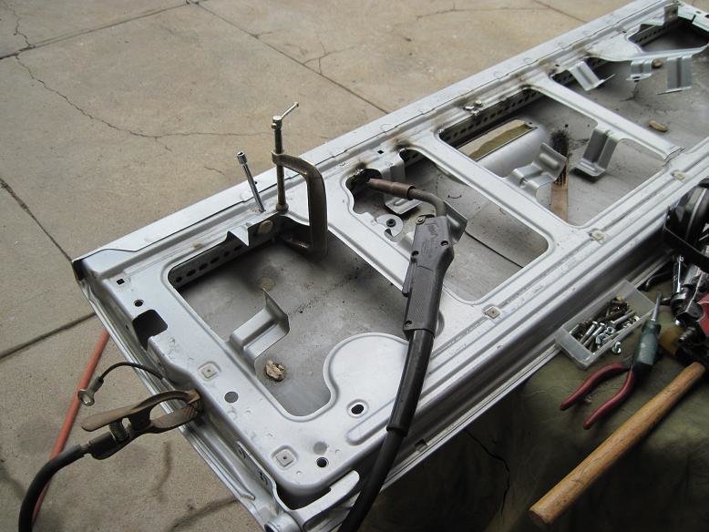

Tailgate reinforcement weld
Here we see the angle iron MIG welded in. Cuts for inserting bar were welded back. Painted any welds and bare metal. Because the bar is galvanized, no paint is needed underneath. Next, bend all those flimsy "L" brackets back and re-glue with counter top contact cement. Should now handle 400lbs instead of a weak 250lbs!
