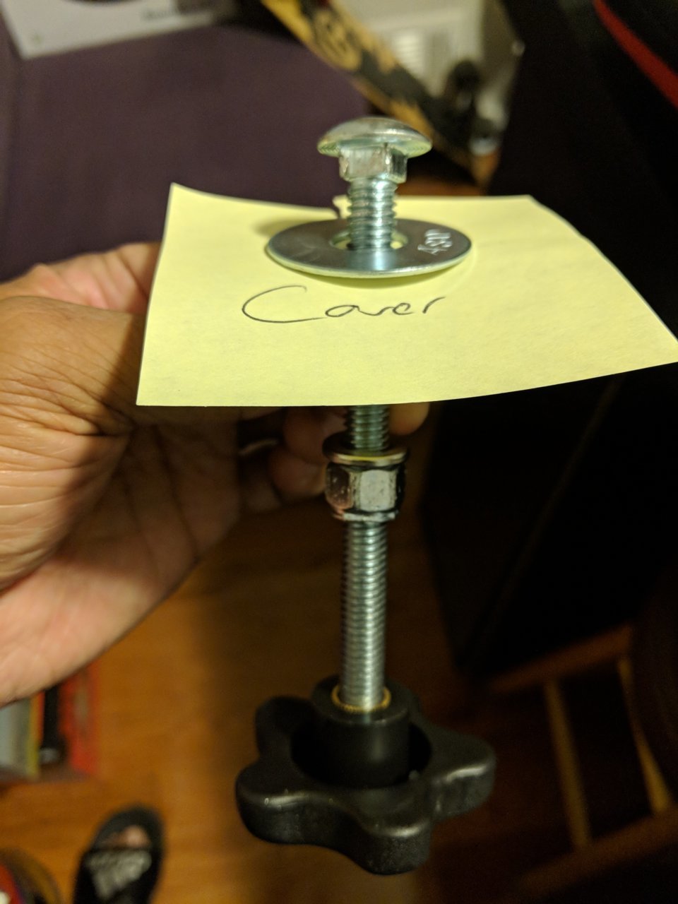

- Insert carriage bolt w/large washer between bolt and cover - under cover, use locking washer w/nut so bolt doesn't come off when unmounting board - doesn't have to be snug - use Thru-Knobs to secure the board to the cover.
