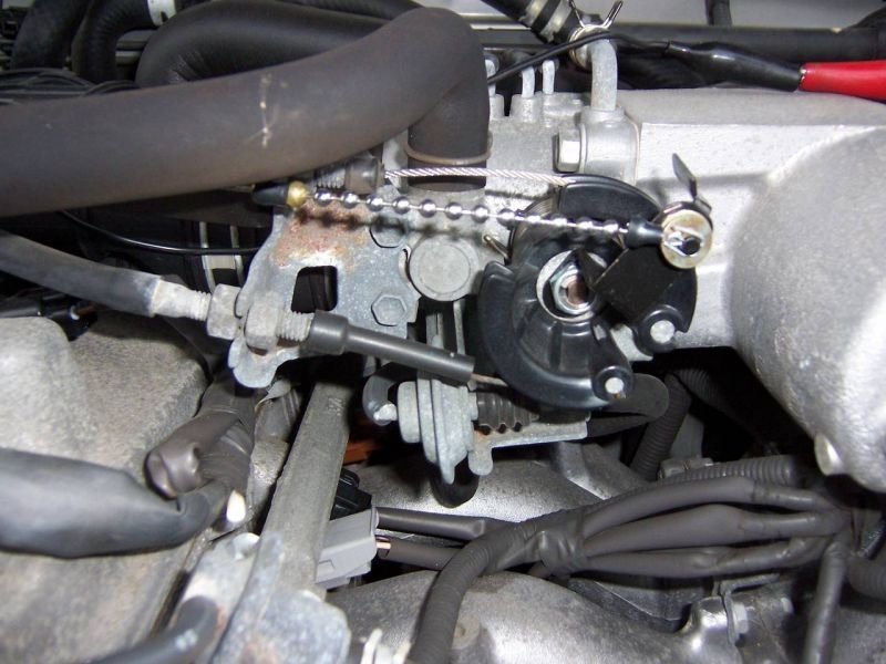

This is the 01-04 Tacoma 2.4 throttle bracket kit installed. I removed the nut from the throttle shaft, they supply a thinner locknut to install the bracket with. Then I installed the chain and cable bracket, very easy!
