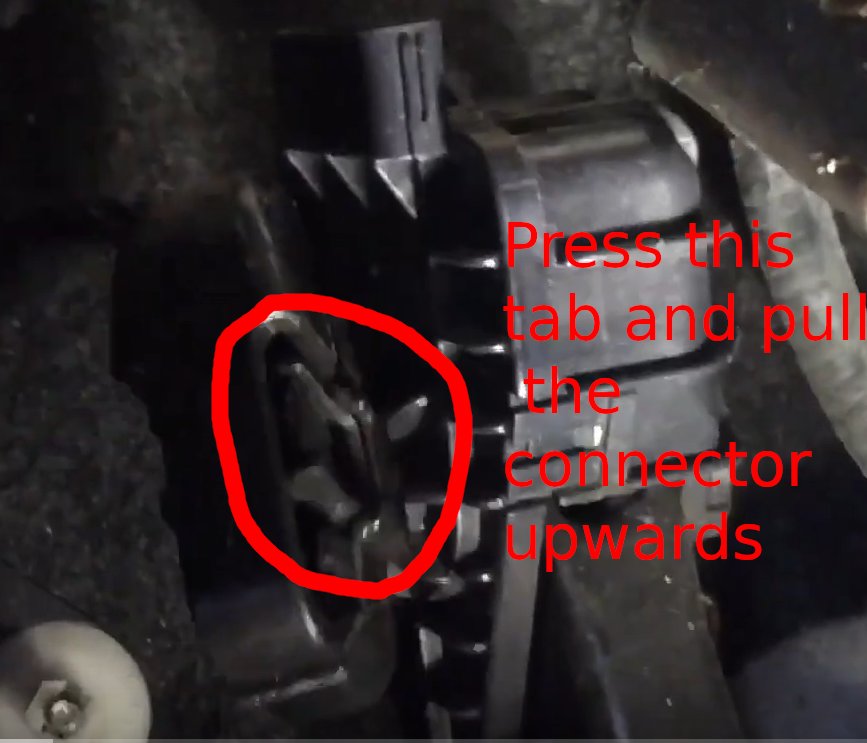

    • Miko21703
      It's kind of hard to tell the angle of your photo, is that looking directly at the connector tab being on the left side facing the drivers door?
    • Jimmyh
      No that is the plug hanging by the wire. Looking under the dash at the pedal connector the locking tab is on the right side towards the heater / ac box.
