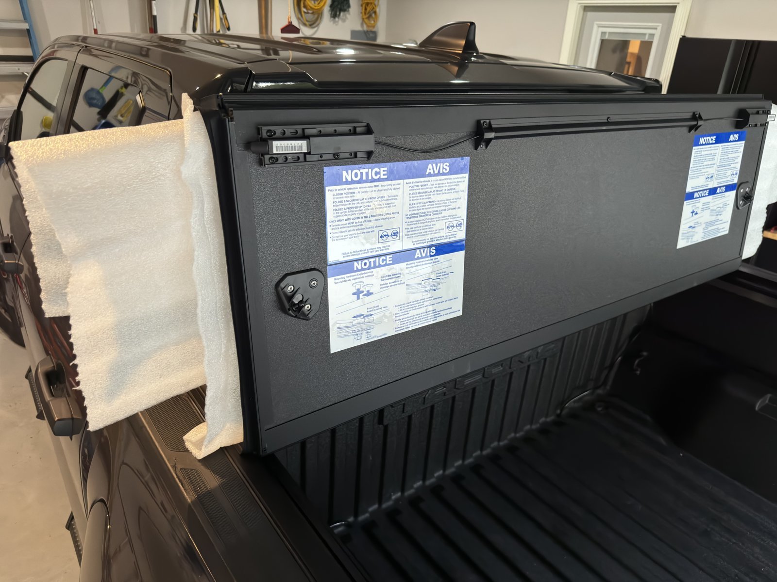

When tightening the front bolts, place duct tape across both bolts on each side to prevent rotation. Fold up tonneau in this manner and you can reach around to hold bolts down while installing washers / nuts on bottom
