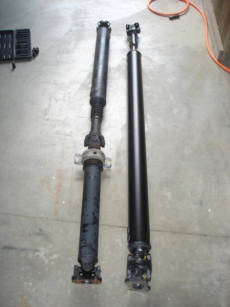

Tom Woods 1-piece driveshaft
Fixes vibrations after a suspension lift.

      Any lifted truck can vibrate. It usually does it during take off or braking. It kinda feels like warped rotors. Nothing real bad, but still annoying. A 2WD will do it too. It's because of the soft rubber in the stock driveshaft's carrier bearing. It doesn't like the angle change of the driveshaft when you lift the suspension.

      When you do a suspension lift many times you will get some driveline vibration because of the changing angles in the drive shaft joints. A 1-piece driveshaft often eliminates or improves the smoothness of your driveline because it eliminates the bend where the carrier bearing is in the middle of the stock driveshaft. Plus the 1-piece is lighter because it has less moving parts, and it's stronger than the stock one.
